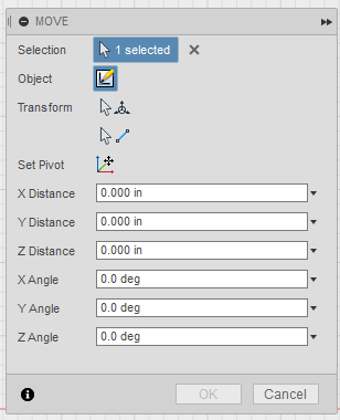

If I try to move a sketch entity, the move command dialog box keeps alternating between collapsed and fully expanded. Here are examples.
Collapsed
Expanded
It only seems to happen when the Move Command Dialog Box is attached to the left edge of the Sketch Dialog Box. If I create a new design, click new sketch, draw a line, then bring up the move command, it will either be collapsed or expanded. If I either exit the move command or move the line and hit okay, the next time I use the move command it will be the opposite of what it was before. If it is collapsed, it wont let me resize the window unless if I unsnap it from the sketch dialog box.
Not a huge deal but it is a little frustrating and slowing me down. I could just detach the move box, but I like it attached. I can live with it, but had a few extra moments this morning and thought I'd point out a tiny bug.

Hi @ARTHUR-HM,
Thanks for sharing! I can reproduce this as well. It does seem related to the left edge only however. It seems to alternate between collapsed and expanded every time I bring up the command. I will go ahead and log this with the development team!

Hi @ARTHUR-HM,
I had this problem before. The fix is, File menu => View => Reset To Default Layout.

I always recommend to have your tool dialogs docked to the right side of the window. Also, the Move command is getting overhauled in the up-coming Jan update, and should address this issue.
