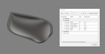

Hi folks,
I'm interested in modeling a flower petal (see photo below). The petal has a cupped shape that is more concave at the base (center of the flower) and opens up as it extends toward the outer edge of the petal. Additionally, the petal I want to design is thicker at the base and slowly transitions to become more thin toward the edge.
Any help would be greatly appreciated.

I would use T-Splines for this as it offers the most flexibility.
While I do use symmetry to make modeling faster, I can always clear it (and reapply when necessary) and then modify individual leaves to get a more organic and varied look between individual petals .
The video is a quick demo to get you started:

Here is a parametric way to do it.
Take a look at the attached .f3d file to check the model parameters and creation process.
Saeed Hamza
