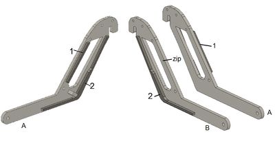

I cannot figure out why one feature of my left side swing arm will not mirror to the right side.
Both 1 and 2 are added as separate bodies on the Swing Arm arm (which is a component. ribs.jpg

Let me see if I can work on it just to show this one aspect of the design.
Let me also add that I went back in time and added the two "ribs" (1 and 2), and then went forward to "edit feature" (of the mirroring). This is when only the 2 "rib" showed on the B side.
Also, I did go back in time just before the "original" mirroring and mirrored fresh (as opposed to "edit feature" that already existed). Then, checked it and this version worked fine. I subsequently suppressed the original mirroring.
I did notice that the new mirroring task gave me options for the pattern type, and the original did not--the original was only set on "components).
