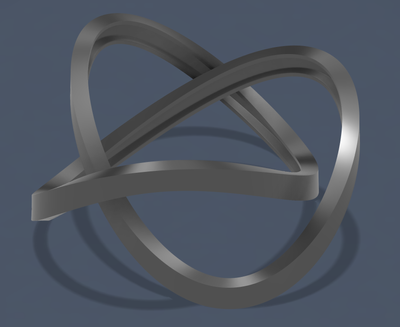

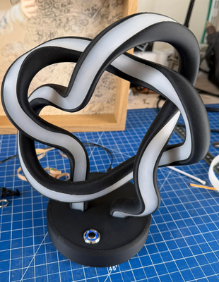

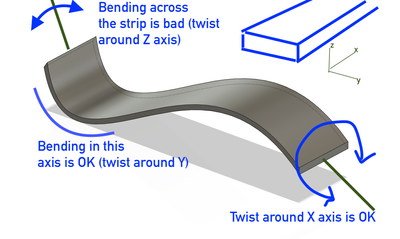

I'm playing with some mathematical knots as a basis for making lighting. I can make a knot, and sweep a profile along it no problem, and it looks great.
Eventually, I want to use it as a channel to hold LED strip, which is very flexible in two directions, and not at all in the third, so I'm wondering if there's any way to control the rotation of the profile along the 3d path to minimise the amount of bending needed?
The attachment is an example - it's a simple trefoil knot. I could probably *just about* run a strip down the channel here if I keep the tolerances loose, but I would probably get into trouble with more complex shapes.
So, is there any generic solution to do a sweep (or similar operation) that has as little 'side to side' torsion as possible?

While that will create a consistent sweep, that is not going to address the problem. I am not sure sweeping along an arbitrarily curved path through 3D space will address the mechanical problem.
The path curve must have specific non-arbitrary characteristics I have not yet figured out.

Agreed. For the overall problem - finding a path that can be followed by e.g. a strip of paper, through a set of points - I think it's possible: just conceptually, you could make this approximate shape with paper/led strip - example attached 😉
The problem is, I think, there's a relation between the curvature of strip in space and the twist is has to undergo, and without having something that takes that into account, it's going to be hard. It could be that splines are not a good intermediate step, or some conditions have to be made over them? I'm guessing it's beyond what is possible in Fusion without adding in something specifically computational. To illustrate more clearly, here's an open pentafoil - if you look at the curve where path starts on the left, there's no way that a strip could follow that - it would have to rotate counterclockwise around the bend.
If there was some way to angle the sweep to always keep the same orientation relative to the angle of curvature, that would probably do it, or at least get close enough. I guess a rail, if we could construct the right kind of path from the original spline? Offset in the direction of maximal curvature?

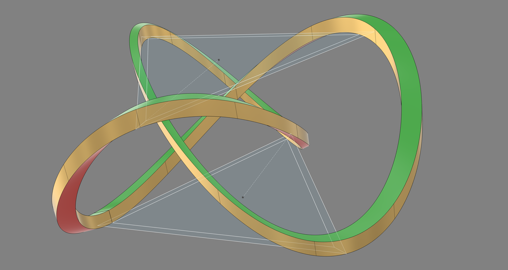

MichaelT_123
Hi Mr DaveMrrayrust,
Here is another 'macka geegee' attempt. If I understood your design intention correctly, I created the trefoil body by stitching its loft faces, making sure that they obeyed the 'horizontal/vertical paradigm as required. I don't think a detailed explanation of 'macka geegee' steps is necessary ... as they are all so natural.
Natural ... in the case of Z-axis with 'light' projections up-green and down-red.
However, the illumination vector can point in any arbitrary direction. In such a situation, the "horizontal" faces should be "lofted" from line segments perpendicular (the closed distance points) to the chosen axis.
Regards
MichaelT

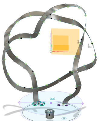

davemurrayrust
I've been building a bit on the ideas from @MichaelT_123 and @johnsonshiue , and the idea that I can't set everything automatically, but if I can manually adjust the rotation of the sweep at certain points, I can tweak it by hand to get something workable. My current approach is looking a bit like this (file attached):
So, I:
- make a 3d spline
- create perpendicular planes along this spline, and put a 10mm line centred on the spline that can be angled
- draw 2 more splines through the end points of these lines (so it keeps the 10mm distance, roughly, all the way along)
- now I can sweep my profile along one of the splines, with the other as a guide rail.
It works, but
- it's really laborious. I could maybe write a script
- it's a real hack - because it's impossible to sensibly make a plane perpendicular at a point along a 3d spline, I can't easily replicate the original spline
- if I need to add more control points, I have to recreate the secondary splines, and that's a pain.
So, I'm wondering if anyone has a nicer way to do this kind of thing? Perhaps something along the lines of putting the profile in a component, doing a "Duplicate with joints" along the spline, and then rotating each one - but this seems to still need a lot of planes+sketches made along the path to anchor the joints to...
One caveat is I don't want to use the thickening etc. operations above - I need control of the swept profile as it needs to fit other components.
Any ideas welcome! Thanks!

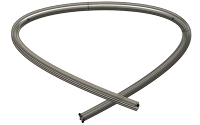

I've found a slightly simpler way to do a sweep where I control the angle along the path: do the sweep in sections, use the end of each section as the start of the next section, and set the rotation amount per section to get desired angles. It's definitely not perfect! In particular, rotating one way and then the other makes a sharp change, rather than the smoothness of splines. It's also a bit fiddly getting the numbers right in Fusion, partly because I'm not sure what the two distances along the path are supposed to be. But - it's much easier than making lots of planes, and doesn't involve an intermediate spline that's ignored in the end.
It would be lovely to have a sweep command where one could set the angle at particular points along the path!

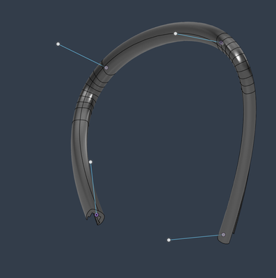

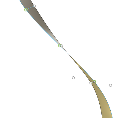

OK, here's a script that constructs the planes and the Surface Loft in one go. I can't get it to do the final Sweep yet - fighting with the API (https://forums.autodesk.com/t5/fusion-design-validate-document/minimal-working-example-of-creating-a...) - but it's fairly usable as is.
One thing I can't figure out is that Fusion seems to concentrate the wiggliness of the Sweep differently to the guide surface. For instance given this curve:
The body created has all the torsion concentrated in the middle:
So it doesn't really seem to be following the surface properly. But at least for gentle curves, it works relatively sensibly.
Next step, I might look into constructing the lines at the 'correct' angle so that they are in the plane of the splines instantaneous curvature.

davemurrayrust
Just to close this topic off, here's what it looks like in use - a 3D strip with a bunch of control handles:
I can then sweep along that:
And get a fairly sensible solid object out:
It's still a pain editing the curve - each time I move a handle it's 20s of processing, and they're quite fiddly! - but it works. Thanks @johnsonshiue @MichaelT_123 for all your suggestions.
