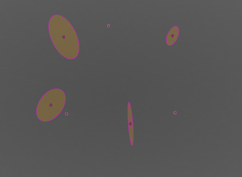

One last point:  With lots of help from our modeling kernel guys, we figured out the "self-intersecting loft" problem.  Your original sketch "HeelEnd", has some points that are very close together.  If you zoom into this area:
You will see this:
When I created the rail for that side, I suspect I projected the wrong point, so the rail did not attach right at the corner of the profile.  This causes the loft to fail.  So, again, you have to be really careful when setting up rail curves that you get the exact right point.
So, anyway, I probably didn't need to reconstruct that portion of that sketch, just be a bit more careful when creating the side rails.  My error...

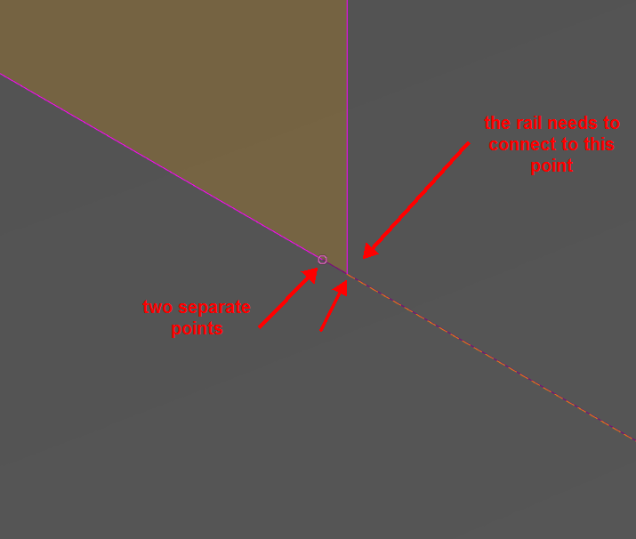

I can answer some of your questions.  I'll start with the one I can't answer:  I don't know, honestly, if there is any single place where all of the colors and symbols are documented.  Such a thing would be useful, I agree.  Maybe others here can point to where this may be documented.
Now, on to your specific loft issues.  I see two problems with your design.  One is related to the issue that I also ran into.  The profile in the HeelEnd sketch has those two points that are very close together.  And this plays lots of havoc with the loft, because the rail curve is not hitting the true corner of the profile.  Here is a very zoomed-in view of that area in the latest model you shared:
You can also see this if you do a Measure and select the workplane at the top and the side face of the neck:
You can see that they are 0.023mm apart.  That plane is related to that vertical line in HeelEnd.
For that one, I had to edit HeelEnd and force those two points to be coincident.
The second problem was the one the command was telling you about:  Your rail is not tangent (G1) continuous.  That one was easier to fix.  Just edit the HeelSpline sketch, and add a tangent constraint.
