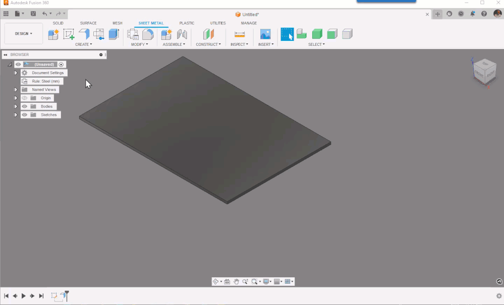

Hi all....I see a lot of posts with people wanting to merge faces, but I'm looking for a way to prevent it. When I extrude or use the flange tool Fusion always seems to merge the faces on the same plane. I can't figure out a way to stop this. I would like the faces to NOT merge so I can grab and manipulate them after the bend/extrude. Am I missing a button somewhere to prevent this behaviour?

If you are using the Bend or Flange tool in sheet metal, you cannot prevent the merging of the faces as that is the purpose of the tool.  On the other hand using an Extrude, you can simply select "New Body" to prevent the merging of the faces.  If you need something else, please clarify your question using a video.

I hope this video makes sense...i seemed to have not captured the tools, but I was using the flange tool. You can see that it merges the faces. I find this strange because this would never happen in the real world so using this as a modeling program as a design tool prior to manufacturing doesn't work well in this use case. Metal faces don't automatically weld themselves together. I think at a minimum there should be an option to prevent this. My apologies if there is and I'm missing it.

I agree, in real life the sheet metal will not "melt" into the face but in Fusion 360 sheet metal, if the faces touch, they will join.  All you need to do is put a "very" small gap between them to prevent this from happening.
