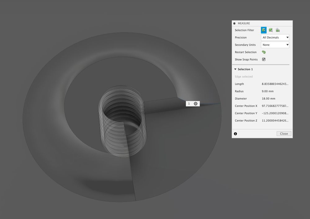

Need to double check the (selected area) fillet radius of this imported bearing model but have been unsuccessful in determining how that is done.

Create a plane on the centre line of the bearing then use Project Intersect, this should give you a rad you can measure. If you can't get a size because you've ended up with a spline draw a 3 point arc on the spline and measure.

I did a screencast for someone a while ago that demonstrates what I tried to describe above, watch the first minute.
 And a tip for making the plane, use Plane Along Path

I posted before you posted the screencast, I did watch but need to watch it many more times to get the drift.
That bearing stack is at a 2º angle which further complicates it for me.
The whole sequence seems so terribly complicated to me though.

Not all fillets are that hard to measure, I think the problem is where you have a fillet around a curved surface. The plane along path should work to get a plane perpendicular to the fillet.

OK, in-spite of you going 900 MPH HAHA it took a few trys to follow the cast but ended up being not all that difficult.
Now I have another tool in my belt 🙂

Another way is to simply cut through the fillet with a box and measure the edge...
Still not handy as the data is there and you are forced to do an unnecessary step that has to be reversed...
