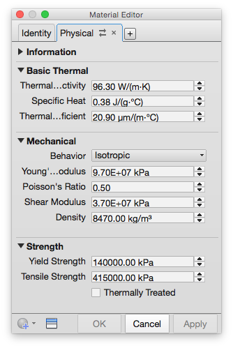

Right click on it and select Edit.
Give it a new name, density if applicable, and then click Advanced.

Switching over to the Physical tab will allow you to enter more physical properties. This is where all your Matlab data can go.

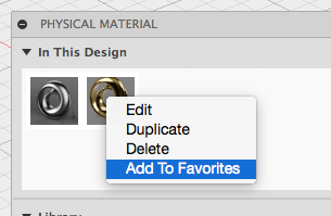

Once you've entered them, click Apply and then OK to finish.
Right click on the new material you just created and select "Add to Favorties". This will add the material to your favorite materials library.
