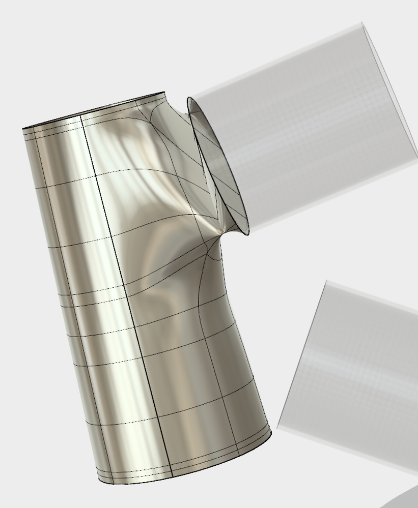

I'd like to use the match command.  I think what I am trying is quite simple, so I don't understand what the problem could be.  The resulting surface is always twisted wierdly.
The T-spline edge is almost the same shape as the solid, so I don't understand why it won't match.

Thanks for posting this you have found a bug!
The face/edge you are trying to Match up with is the problem. If I replace the face, the Match command works well. The easiest way to do this is extrude the face -1mm to cut it, then extrude it back +1mm to the original position. Now there is a new face and edge in the same location and Match is happy.
I really need to know how you created the face/edge in question. Without any parametric history, it's very hard to tell. But if I knew the workflow I could test against any other places where a user could create this situation. Any help you can provide is awesome.

Good news, in the builds I'm testing for Match improvements do not have this bug. The Match simply works just as you expected it to. The good news is this next update should be in only a few weeks.
I would still like to know how you made the face so I can test around the workflow.

The body was created by extruding from the sketch "TT inner diameter".
I tried your fix and it did not work!  However, I re-extruded from the same sketch profile and the T-spline matched nicely with the new body. Wierdness.

First, addressing the specific problem you found, there are some things I want you to be clear about.
When you attempted to perform the workaround I showed you, there was one key error. I asked you to extrude the face as a cut, then extrude it back into position. You used Press Pull. There is a huge difference in these tools.
In this case, Extrude was used by me to remove the error face. It literally cuts it off the model. By replacing this face I gave the Match command a new target face. You used Press Pull which can do a lot of things, but in this case Press Pull preserves the face. In fact, Press Pull tries, in this use of it, to preserve the input of the face you are press pulling. It preserves the body/face/edge tagging in both PM and DM space. Tagging helps commands know what geometry is what.
Press Pull is multi-purpose, it launches a command that is appropriate for the input you give it. This is why you can Press Pull on a sketch profile and it launches Extrude. You can use it on an edge and it launches Fillet. In this case it launches Offset and offsets the original problem face. It keeps the bad "tag" for the face. Your results at 2:12 in your latest video show that the original face was still being used by Match.
You state "In general I feel like I am just clicking randomly on things and sometimes they work. Why should re-extruding suddenly work?  How should I know to do this?  It would be really nice to understand some of the intentions and concepts behind Fusion 360."
I want to point out that you found a bug. This is not an intention of Fusion 360! So there is no way for you to know how to do this, and as soon as possible we will fix it. Nobody expects you to know these things. I figured it out by giving Match command different input. If input A doesn't work, doing it over and over is futile. Try input B instead. The match worked at a long distance, and not at a short distance. I started by removing 10 mm of tube thinking the Match command needed more space. I then figured out it didn't matter the distance so long as I removed the original face. The rest you know.
