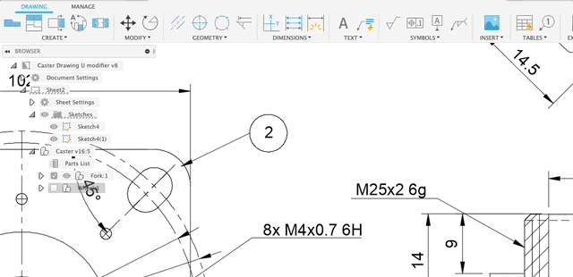

I'm currently creating sub assembly drawings for some welded steel fabrications, and the way I have broken down my model tree includes some sub assembly components being made up of multiple bodies that I want to identify individually in the parts list. Upon discovering that the automatic parts list function will only work with components I thought fine, next time I'll bear that in mind when deciding on a tree structure, but for now I'll just create a manual parts list. So I create and populate the table which didn't take long, and then add the balloons. So I now have three balloons all with the number 1, but I want 1,2,3. The 'renumber' function does't help at all. If I select a balloon and change it's number, then all three balloons change, presumably because they are all pointing to the same 'component'. This behavior really is frustrating. Is it really this restrictive or am I missing something here?

You are spot on, the re-number tool is going to re-number all instances, as the balloon is pointing to the component instance. As it stands, the Balloons are tied back to components, this way we track then on the drawing and understand when they are updated or re-numbered.
In your example of a workflow with bodies, I can certainly see the frustration you have.
One thing you could do in this instance is use a sketched symbol for your balloon, once you have created one, they are pretty easy to copy and adjust, see GIF below.
