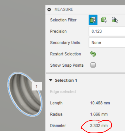

I added 4mm Holes in my design so that after sending the part for cnc milling, i will use a thread drill to create the threads.
I want to use M4 screws, so the question is , is 4mm diameter for the hole correct or should i use less that 4?
On the design i added the m4 thread without the modeled optio
Thank you

TheCADWhisperer
On the design i added the m4 thread without the modeled option.
No Ø4 is not the correct hole size - there would not be any material to cut the thread???
But if you use the Hole-Tapped command then Fusion will automatically enter the tap drill size (smaller than 4mm).  If you use the Thread feature command then Fusion will automatically change the hole to the tap drill size (smaller than 4mm).
Did you measure the hole diameter?  Your picture doesn't show the critical information.

an18211821
you are correct, the dimension did change automatically. Thank you!
