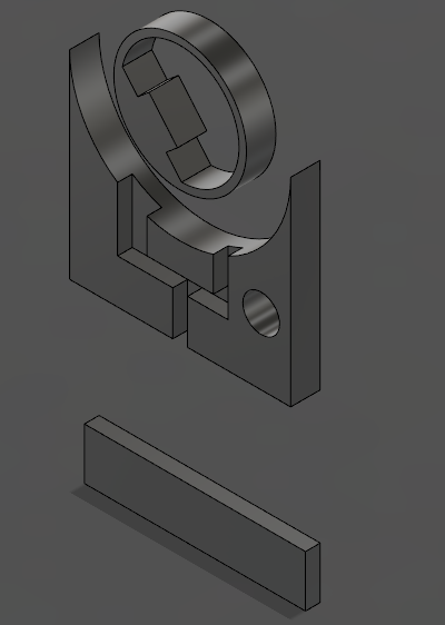

I've built a fairly simple model using a sketch and then extruding the features of the sketch.
When I came to modify one of those features, I seem to lose a stack of the other features on the model.
I'm not (to my mind) doing anything overcomplicated, but I must be breaking a dependency of which I was not aware.
I've created a video to show the behaviour here.
The model can be found here.
Can anyone tell me what I'm doing wrong?

I spent some time today with your model.  I think that the main problem with these features is some missing sketch coincident constraints, to make sure that the sketch profiles stay intact.
For instance, for Extrude 3,
here is what it is supposed to look like:
but, after the edit, this is what it looks like:
to fix it, I had to add some coincident constraints, and edit a couple of features:
Feature 4 is a similar story:
should look like:
but actually looks like this:
So, I had to do a similar repair job to add some coincident constraints:
after that, as near as I can tell, the rest of the design computes correctly.
