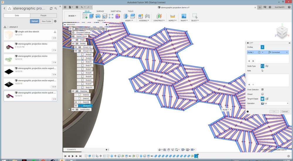

I'm trying to make a semi-circle stereographic projection cover but am running into some trouble with the Loft function. The overall goal is to project a pattern from a plane to a point (pictured below) and having that projection cut away from a semi-circle shell, so lofting appears to be the best tool for the job.
This is what the pattern looks like, in the following screen captures I only use a small section of it so as to not clutter the screen:
When I select a simple "hole" in the pattern and use Loft in it's "cut" mode, everything works fine:
But when I try to select the area of the sketch I want to "keep" and try to use the "intersect" mode, it acts as though only the outline of the sketch has been selected and ignores the holes:
Is there a set of parameters in the Loft function that allows the lofting of a sketch with holes in it? Or a function other than loft that's more suited to this kind of work? Lofting each hole individually is an option but will be super time consuming.

Fusion Loft, can not Loft hollow profiles in one go.  It takes two Lofts for the result.
1 You Loft the outline - Solid
2 You Loft the Cut from the solid.
In your case case you have the solid, so each window will be its own Loft.
