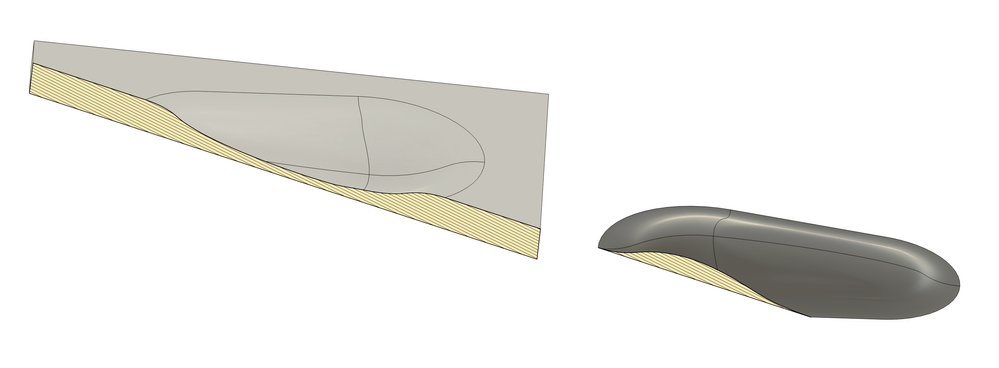

metd01567
I’ve successfully created this body by lofting from a stack of 2D sketch profiles with guide rails defined in a separate 3D sketch.  Note the last loft profile is a single point.  This has a flat back surface with a single face (not shown).  This body is used to cut a larger flat surface, the edges taper down until they are tangent with the larger flat plane.
I want to drape the body over the intersection of two planes, with a filet at their intersection. I’ve attached the design.  Because the fillet creates a middle face, each stage of the loft is broken into three profiles.  Which doesn’t  work.  Using three separate lofts joining together, I managed this (without rails):
I tried using rails, but they aren’t right and weren’t accepted by the loft command.  Plus I suspect there will be discontinuities even with good guide rails.
My goal is to achieve a draped body with form similar what was achieved with flat sketch profiles.

metd01567
A nine year old would do better hand drawings than me.  Here are a couple of cross sections that might get the idea across.  First, here's a screenshot from FlatForumTestShape (attached with my second post), which works as I want.  The lighter left body is the actual end result.  I've cut a flat plane with the body on the right (which I've flipped to show in cross section).  I am willing to loft directly into the flat surface if it helps, but I started this thinking plug and mold.

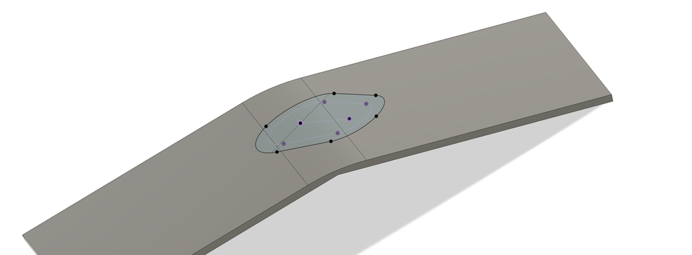

Now I have to cut an angled surface, which I tried to do in the design attached to my first post.  The start profile sketch is shown, spanning the filet between the two flat surfaces.  The sketch is referenced to the right hand flat surface.

So by "draped", I mean the plug with be bent along the filet, while retaining the basic shape.

davebYYPCU
Use Sheetmetal Fold / Unfold, but the end result may not be what you wish for.
Might help….
Message 8 of 8
metd01567
Thanks, that will do what I want once I incorporate it into the main design.  I haven't studied the sheet metal commands, it looks like I should.
