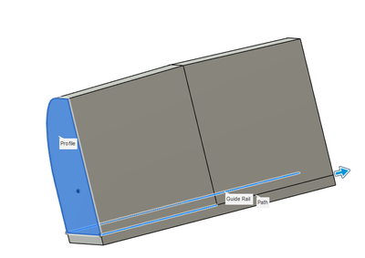

I have a fairly simple design that I made but forgot to save it and I have to recreate it and for some reason I cannot get it to work right even though I made it work a few days ago. There is a base that is rectangular but on one of the sides, there is a small "bulge". I have the side profile created, but I cannot get it to work how I did previously.
I can use Sweep but it doesn't follow the bulge in front.
Or I can use Sweep with path and guide rail and it follows the "bulge" but the top is not flat, it has the "bulge" as well.

Change the Sweep option, Scale to Stretch.
Might help....
poporacer
That actually did it, but I know that is not how I did it the first time, Thanks!
