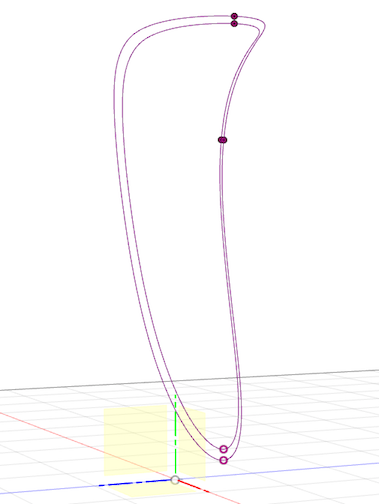

Hello!
I've got a problem with loft rails intersections with profiles. I've tried to do a basic bottle shape with sculpt function and tried to add some additional features. I didn't manage to get even tangent between middle intersection lines and a shape profile (spline). I have now found a couple of times times, that there is some problems with loft intersections. I published my bottle file; http://a360.co/1SiH7nv

Hi @0502880
I was able to get a surface by sweeping the bottom curve along two path curves that I created by intersecting the two bottle bodies with the curved surfaces you used to create the offsets.
I selected to bottom curve and used the two intersection curves as a path and guide rail.
The Loft tool should have been able to make this surface but we have determined that there is a bug in the Loft tool that is perventing it from working.

0502880
Ok. Did you try to get a tangent constraint between the middle shape splines and existing two construction lines? I didn't manage to do that. I tried to achieve a smooth (filleted) surface between those two bodies. Now there is a sharp edge.

Hi @0502880
I didn't get fancy with the curves, I was more concerned with getting the loft tool to work.  There is a bug logged for this, it turns out to be a tolerance issue.
Of course you set continuity on the curves, or you could leave it sharp and then fillet/variable fillet the edges.

donsmac
This form of the bottle should to be easy to model using several methods but I came across problems at every turn, to create a body that could be filleted.
I did manage to do it and made a screencast showing how. Although I was not successful while doing the screencast, that is how I did it earlier and got good results.
This is an excellent project to show several problems with the software. Highly recommend that the programers give it a shot. Try out all the ways that should work. Much will be revealed.
Note: for a successful execution of this model, I had to widen the gap between the two parts: I used two splines on a sketch to split the bodies. Delete the unwanted bits. I cut the bottle in half. .... I did a new 3D sketch and did a solid loft. Mirror and combine. The fillet worked fine (no need for a variable fillet). Good luck. The screencast is highly edited, it's enough to show the idea.
