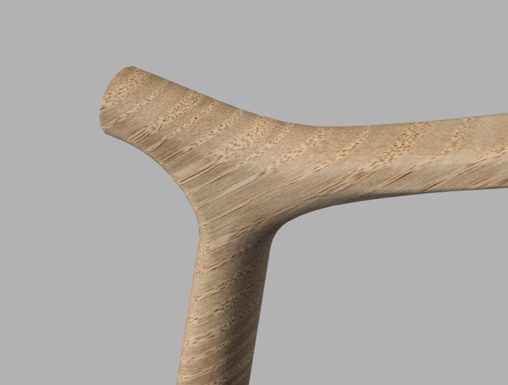

Hi everyone,
This is my first project on Fusion although I have gone through tutorials and think I have a good understanding of the basics by now. It would be great if the following could be cleared up:
For the joint between the armrest, the back leg and the connection between the two armrests, I used loft. This however does not give me a smooth transition. I used Loft in other areas as well so I wonder if for this problem, I better use an other command?
And if i want to smooth out other areas of the model, is it best to convert to T-Splines ? ( modifying the same joinery after converting it does not go well)
Another issue is that when i want to shorten the back leg, the armrest goes down as well. I've tried removing constraints but this remains a problem where i can only redo the spline that makes the armrest.
A more general question, and hopefully also appropriate to ask here: Looking at the design history, did I make mistakes/create potential issues in the future. Parts of this chair need to be CNC'd so I need to get this model ready for that process as well.
Thanks in advance,
Ruben

davebYYPCU
Can see your file, but downloading it will be later in the day.
search for 3 way tee Joint, can be solid modelling, or surface.  I would investigate a patch tangent to the 3 arms.
shorten the leg, will have to have an effect, so you would reduce dimension below the seat to maintain arm to seat distance.
Might help for the moment....

all in all it's a good showing for your first time out.  general thoughts would be
-you've referenced from a sub-component back up to the top level component, which strictly speaking isn't wrong, but I try to avoid it on more complex models because it makes things less stable and harder to debug.
-on sections you want to be straight, like the Center section of that leg, you might consider a short sweep, and then lofting to the sweep.  otherwise you can end up with funkyness like this curvature-
sweeps where 3 parts come together are challenging to loft.  you'll need to beak it down a little differently to get a good joint there.  I noticed that none of your guide rails are tangent or better at this location.  you can do that by creating the solids you want to connect to first-
create rails that re tangent to the solids, you can split the faces to get something to apply a tangent constrain to.  Tyo may not need the guide rails at all.  try just lofting half the cross sections together with the end conditions set to tangent or smooth, and adjusting the weight.  that might be enough.  if not put in the rails.-
this might also workbetter using surfaces instead of solids.
pic of first loft position
make 2 more like this
then patch the triangle gaps together.
attach is a rudimentary model using the same idea but with sweeps instead of lofts.

easy one first.  the sketch  AlternativePathFrontLeg has a projections from the sketch armrest. that's why you can't drag it forward anymore in the time line than that sketch.  do you have "auto project on reference"  checked in preferences?  I prefer to leave it off and project my references manually so I don;t get accidental referances.

here's your file back with the three way split.  I added a radius line to each of  the three sketches that defined the ends.  used those to split the faces. had to switch over to surface mode, lofted edges together, patched the opening, stitched it back into a body.

I understand the steps you take but in my new model this does not work. The faces of the armrest are fragmented and i'm trying to find a way to reconnect them. But I don't see where the problem lies.
The loft I want to do after splitting the face in 2 gives me an error ( i think because i need to select multiple pieces of the face to make up for one profile.)
The workaround that I used, extruding the last profile of the armrest before trying to make the joint, works. But that does not make for a clean model.
Do you see the problem in the attached file?

I took a quick look,might have more time this evening.
the 2 sketches defining the arm are a mess.
-you have several tangent  issues
-there several places where curves overlap instead of meeting endpoint to endpoint.  you need to make sure the endpoints are coincident.
-there are short arc segments hidden in among the other curves.
-there is this in sketch armleg3
-I've experienced general performance  issues in the past using trimmed ellipsis,  there use to be bugs associated with it, and I suspect they are still problematic.  I would approximate that with a fit point spline.  in fact, I would do the entire profile with a continuous fit point spline and eliminate the arcs also.

Replacing the ellips with a spline did the trick.
