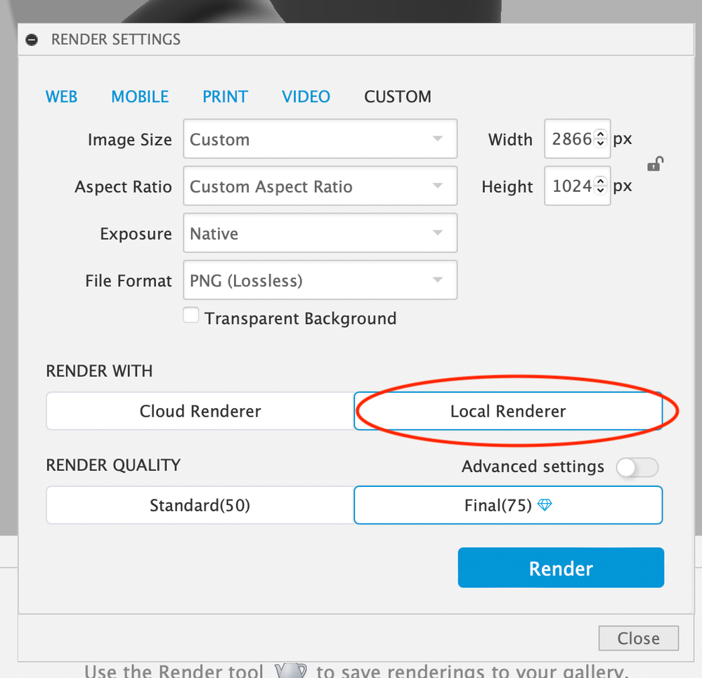

There are TWO ways to do a local render:
 1) The Render command still has a Local Render option:
and there is always the in-Canvas renderer:
