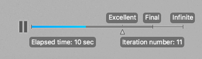

et.teljemo
What is that exactly.. a lot of particles making the image higher and higher resolution..
Is this another way of rendering or just a preview future??
in canvas renderin canvas render
Message 7 of 8
TrippyLighting
Fusion 360 progressively refines the rendered result. How far depends on what you've set the slider to once the render has started.
The Canvas render engine and the cloud render engine are the same (supposedly). I'd use the cloud render only for the final render so as to not burn my club credits.

Message 8 of 8
SaeedHamza
You can call it a fast local render which keeps getting a better resolution
on time
We use it in order to get an initial idea of how the render is going to be
