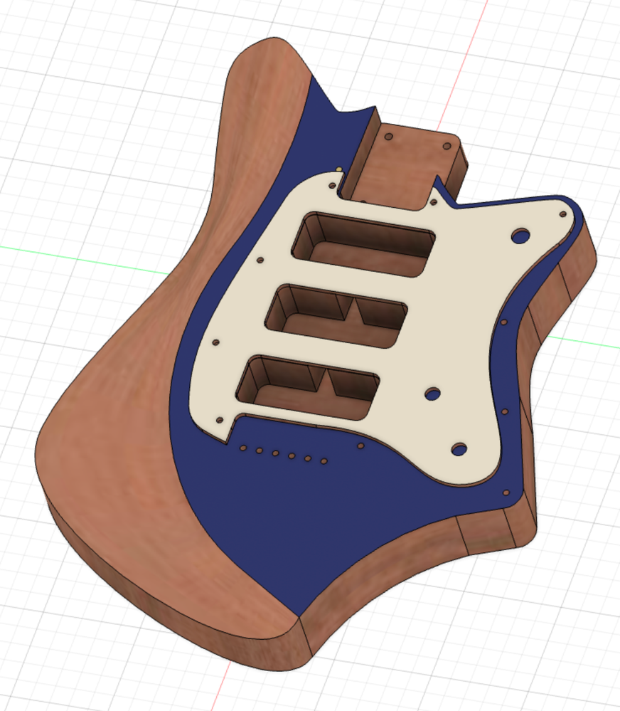

I love this guitar I'm designing but I am just not feeling the pickguard design and am frankly tired and a little bit stuck. The guitar has a kind of vintage feel about it and I want the pickguard shape to have that kind of 60s car flair that I feel the lines on the guitar do. Just wondering if anyone has any suggestions or would want to collaborate.

My take isn't much different than what is shown here.
Try to make the shape be independent of the surroundings. Let the hardware float above it as if they don't touch. Let the arcs continue as if uninterrupted. Don't make the pick guard follow the body, where possible. The pick guard is jewelry and the body is the work horse. This method creates layers that draw you in, give texture.
Might need to move some of the screw holes to accommodate a new shape.

Looks good dolled up with some fillets and glossy paint.

Interesting project! It's looking really nice.
I don't know diddly-squat about guitar construction either, but my subjective first impression is that there may be a bit too much visual weight in the green-circled region below:
I don't know that the right side really needs to follow the body edge so closely, either. The contour up to the red-circled area feels right to me, but after that I think you could stray a bit more away from the edge in order to trim off some additional bulk.
I like @Phil.E's urge to uncover the central cavity too. That adds a more structured rhythm and removes weight. All together, something like this:
This is just for illustration of the schema - clearly, these aren't the aesthetically optimal curves. And I cheated! By moving the knob holes and filling in some of the underlying cavity. I don't know if this layout is even mechanically plausible for a guitar.
Message 6 of 9
evanDXG2P
Wow. This rules. I will probably have to adjust the spacing near the bridge just a little bit due to the shape of the hipshot bridge but this looks fantastic. Thank you!
