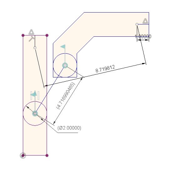

this mechanism has been haunting me for some time now.
trying to get the design finished before the end of this month
this is a very simplified and scaled down version, of the motion i am trying to achieve.
i can get this far, but that last joint i cannot get to work
the real model has a mirror image of this mechanism facing it, with soild bars running between to tie them together
i have been succesfull, just getting a joint to work for the upper wheel, using contact sets by itself.
but not once i have it part of this entire piece.
this seems very simple. i am sure i am missing something
anyone know how to do this?
thanks, Brian

How is it supposed to work?
ETFrench
Message 4 of 17
TrippyLighting
The only way I know how to make that work in Fusion 360 is with a contact set between the "box" and the "upper wheel". YEOu'l have to make the upper wheel slightly smaller in diameter than the slot it moves in.
HOWEVER, I would like to advise against using contact sets in anything real outside of this simple assembly. They eat a lot of performance and in a more complex assembly normal joint can start behaving odd and outright dysfunctional.
Message 5 of 17
dieselguy65
Sorry, i didn't explain. Kind of figured was obvious. The l shape piece
starts out with the long leg in line with the straight slot. Both rollers
in their respective slots. As the l shape piece moves, the roller along
its long side travels up the slot. It rotates in the l piece. The other
roller needs to follow the slot it is in. There's the problem, i can't
get a joint to do that, as it follows it, the l shape piece transition
from the original position, to a position at an angle, that is regulated
by the slot thr upper wheel is in. I been working on the big project alot
of hours. Just drew this simple example because i can't share the full
project publicly.

TrippyLighting
Did you read my post ?

yes, contact set is the only way i found. however, the real model is big enough fusion locks up as soon as i enable contact sets.

Message 16 of 17
dieselguy65
here, i edited the model. to give more range of motion so the path is clearer i hope.
i also enable contact sets.
now you can see how it moves.
what the movement does now is what i need it to do.
but without using contact sets.
as Trippy said, i do not believe its possible.
it seems like a simple movement, that i have been a year now trying to find a work around, it works on this model, which is similiar enough to the real one to be used as proof of concept.
but it locks up on the real model.
honestly, this is the deciding factor between me sticking with fusion, or moving on. i feel this is very simple to make work.
i dont want to learn Inventor or Solidworks just to do this. but i may have to,
there will be many more models of the movement coming thru in the future. only varying in dimensions but the same principle.
i have to be able to provide customers a working 3d model of the design. otherwise, i am down the drain before getting off the ground with this new business venture.
i am completing the final stages of the first unit in the field. but all the work on that 3 angled slot was done old fashioned way by hand calculations. no fun at all when there is a software as powerful as this on the market.
fusion has done everey task i have needed, other than this one. which is a real downfall
