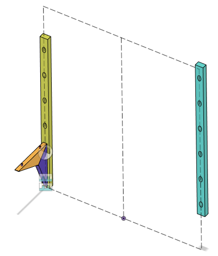

I am experiencing strange behaviour when trying to join to imported components.
For a modular shelf system, I am using a separate model for each component.
There is a Post model, a Bracket model and (a yet to do/ simple) Shelf model.
There is the "Bookshelf3Shelf260mm1Bay" overall model which is based on importation of components from each of the other models.
My overall plan is that by having each component as a separate model I should be able to easily implement an alternative shelf system.
For example, the next could be double width having 5 shelves and 3 posts (2 bays) which I would implement as "Bookshelf5Shelf260mm2Bay" model.
[There could be other future variants having different shelf widths - hence the 260mm in the current model names.]
The Post and Bracket modules have been implemented without any issues.
The general plan is that "Bookshelf3Shelf260mm1Bay" will not involve design of any additional components of its own but simply integrate the various imported components.
For this overall model, I have a sketch with a simple rectangle, the main purpose of which is to define the required horizontal spacing of the 2 posts that are to be imported.
My plan involves joining the posts to the construction lines of this sketch.
This simple sketch is fully constrained, with the bottom line being centred on the origin.
I now import the post, refer graphic:
Issue 1:
The next step involves joining the imported post to the construction line at the left.
It does not seem to be possible to first select the joint location on the post and then on the construction line.
However, it is possible to select in the different order, i.e., the sketch line and then the post.
(Is this a Fusion 360 bug?!)
The joint occurs.
However, the post has remained at the origin whilst the sketch has moved to the right.
(The origin is now (401,0,0))
Since the sketch was fully constrained, this was not the expected behaviour!
I now ground the post.
[Another approach could be to ground the sketch - but it seems that is not possible?]
I then mirror the post.
I then import the bracket, refer graphic:
Issue 2:
When I join the bracket to the desired position on the post (at its lowermost hole), the bracket remains where it was whilst the post moves down 😞
This is surprising given that the post had previously been grounded!
At this point the origin shows as being at (401,0,-191) instead of the expected (0,0,0). (z is vertical)
At this stage the browser is as illustrated:

davebYYPCU
I need the assembly file to decipher the written word.
Why is the sketch not grounded, it is the base article in the system.
Parametric spaced holes across various files, not sure about that.
Where are the joints discs positioned and where are the part origins?
First impression, you don't need the sketch,  First post is positioned as required on import, repeat for the other imports, and as you don't have the shelf, being the dictating component, you have the cart before the horse and in trouble.
Might help....

davebYYPCU
Got the File, I am first to admit, my models exist in one file, with fasteners etc imported.
Sketch is Grounded,
Four inserts, jointed the brackets to the post because you had the discs in place,
Rigid group, done.
Is there a problem with this setup?
Might help?

davebYYPCU
You Ground the component that contains the sketch.
Yes, Point to Point when it arrives. (Any way that suits, it's free and where you need it)
Even so, this then requires something to lock the post in place,
I would have done the same with the brackets, but you gave me joint discs to save the maths.
Rigid Group the whole lot, as there is no movement involved, and would save having any joints.
Parameters - each imported component brings it's own set, so there are two sets of the same parameters that can't be edited in linked posts, no point.
A Master file with parameters and components made in the master file, would work,
but you want to use library parts.
I have not explored the Edit in Place for linked components, but I still think working in one file is more logical than your attempt.
Save As - the master file, modify for the next version.  (One set of parameters to update - makes more sense to me)
Might help....
