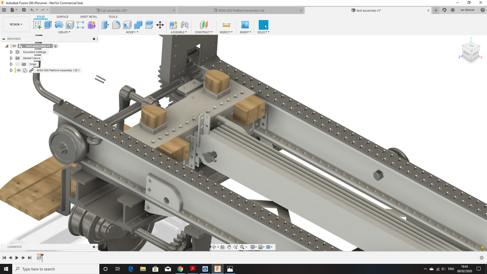

I have a Sub Assembly that looks just as I want it to look. When I add that Sub Assembly into my main design components of the sub assembly have moved. Any ideas why?
I use the workflow of creating smaller Assemblies and adding those into large designs and have never seen this before.
Here are a couple of screenshots to show what I mean.
The first screen shows the Sub-assembly, (note its version 38)
The second screenshot shows that Assembly inserted into a new design. (which is also Version 38) where a number of components have moved.

I have found to answer to my problem, it appears that I have inadvertently moved some of the components in the sub assemblies and not captured their position. Deleting and re-inserting those components in the sub assemblies in the correct position has fixed the issue.
