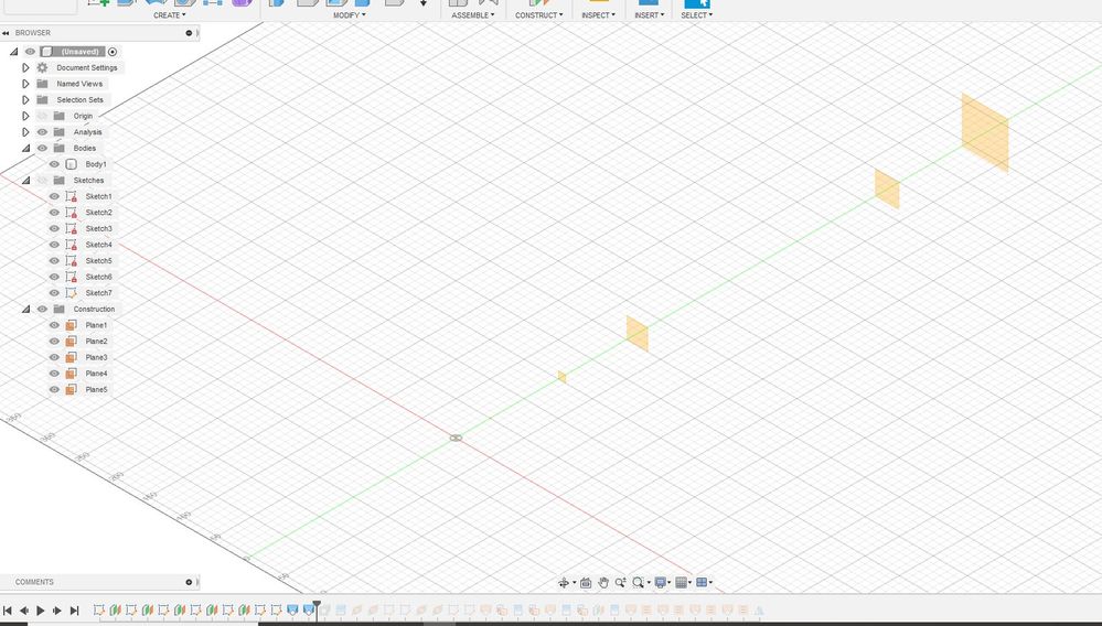

I am designing a 3d printable RC airplane. All components have been weighed and drawn out on paper so I have a rough idea of where everything needs to be to maintain proper CG. This has provided me with the cross sectional area in terms of X & Z and the spacing between all the needed sketches in the Y direction.
While working through the nose of the plane I decided to try lofting the first few sketches to see what the result will be and I noticed that there is an odd buldge here. This is the sort of thing that I normally solve in Inventor by adding more sketches in very short intervals to more precisely control the shape of the loft. However this is also very time consuming and I wanted to ask if this is the best method or not?
The first sketch of the 4 I have so far is a single point, and I noticed that when I set the loft at that point to a tangent I can modify the weight of it so as to control how pointy the tip is. I am wondering if there is something simalar to this for the other sketches the loft passes through. The top edge of the nose is correct but the bottom has a buldge:
Is the best way to fix this just to have a few sketches there only a few mm apart? For frame of reference the nose section seen here is 250mm long.

I will reply to your post in more detail later, but from the model you posted you've not honored a single piece of advice I've given you so far.
If you really are interested in higher end surfaces, then you need to abandon solid modeling. For simpler situations solid lofts work perfectly fine but this is not so simple 😉
Your solid lofts do not look OK to me. The reason for these bulges and unexpected surface dimples and deformation is that you are trying to do too much with one loft and then try to fight it with rails. That is only going to work to a degree, and will certainly not create the geometry that can be created by breaking this up into different lofts.
I am a quite puzzled by your statement that we are stuck wit lofting from filleted Sketches, when he model I presented does not use any filleted sketches whatsoever.
Read though the following materials. These are  The Autodesk Alias Theory Builders. While they are part of the documentation for Autodesk Alias, a high end surfacing software, the concepts explained therein apply generally and as such also to Fusion 360. This will provide you with the foundation to continue this conversation.

So after along bit of experimentation in Fusion 360 and ZW3D I've again come to the conclusion that for all shapes involving lofting, keeping  it simple is key to success. Success means that sometimes one simply has to make compromises.
The center loft uses two profiles, G2 tangency weights and 2 side rails. The rails are needed so the loft at least  appears to be symmetric. With compromise I mean that one must not pay attention to the iso curve analysis.
Trying improve by control a loft with more rails profiles etc. is simply not going to work well. Curvature map looks OK. Zebra stripe analysis is meh...OK.
The workflow in the attached file is what I ended up with: Not great, but not too bad either. The tip can certainly use a little work. None of it was done in solid lifting, even though the center portion could probably have been.
