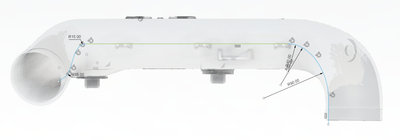

Simple question, everything is in the title : the intersection curve tool works best with splines.
Personnaly it's not my thing to work with spline, i want everything parametric with constraints and dimensions.
So its pretty annoying to work with intersection curve tool when you use lines and arcs.

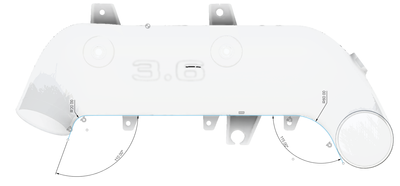

Lets take example with this object i have to reverse engineer. Here's the 2 sketches i would like to merge with intersection curve tool.
When using intersection curve tool, as a source you can select only one curve. Problem is if you have a line + a tangent arc, only the line or the arc is considered as the curve, not both.
In this video below, you can see if i try to select the arc after the line, it doesnt work.
So i am forced to do step by step.
(view in My Videos)
Fun isn't it ?
