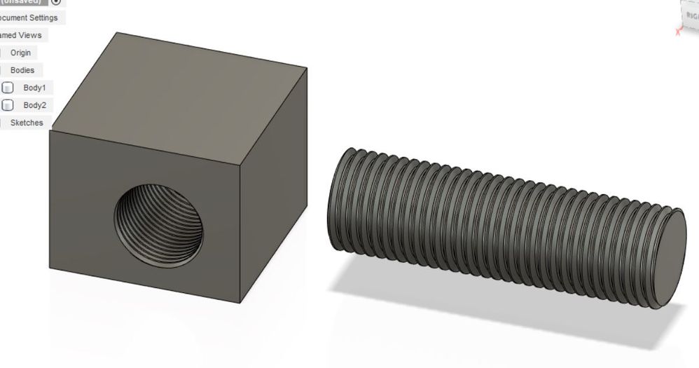

I have the same issue, im trying to intersect two modelled threads but just cant seem to produce without making an error. I tried making a new file and intersecting two threads just to make sure its the same error, and it was. The program cant seem to compute two modelled threads, should be a very important bug to be fixed as its actually a very common operation in machining industry, where im working at.ASDVASV.JPG

i have produced a some sort of solution for this issue. i made a 3d solid with a threaded hole, then i made another cylinder threaded solid.
then i intersected both solids, then used the COMBINE command then using the cut operation to come up with a two intersecting threads. although this may seem like a solution im not sure if it actually is, because as far as i remember there is a difference between inside and outside thread,

This is still an issue. A better solution is to create a positive solid (by using the internal threads to cut from a solid). Once you have all the positive solids in place, they can be combined. After this, they can be combined with the overall solid from which the threads are going to be cut, using cut instead of join.

No. At the very least, there is a clearance set between them, depending on the settings in the XML file for that thread. In this case, it was for 3D printing, but it's mostly irrelevant to the question at hand. Regardless of the medium, there needs to be some bit of clearance between parts, and all the built in thread standards have this. [Just for completeness and anyone reading this who isn't aware... Internal threads refer to the threads inside the piece that the screw or bolt goes in to. Female threads. External threads are on the outside of a piece, the bolt or screw. Male threads.] Since the thread tool of Fusion 360 doesn't allow for crossing of threads currently, I created a positive solid of the internal threads separately, joined them to one solid, and then used this to subtract from the overall solid. I don't have pics of the steps, but here's the final product:
