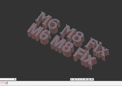

I am now able to select the font in the sketch.
Unfortunately, now I get a 'cannot complete extrusion" error, when trying to extrude the text.
When trying to explode the text in the sketch, I get another error: "could not retrieve the profiles of the selected text".

erik.toussaint
Hi Mark,
The texts I tried were "M6", "M8", "Fix" and "<----->".

I managed to get it to work by first converting the font to postscript .ps and then back to .tff, using the following site: https://convertio.co/
There was an issue with the number 8, which had intersecting lines. I had to explode the text and trim those lines, but after that it worked OK. Still not perfect, but good enough for now.
