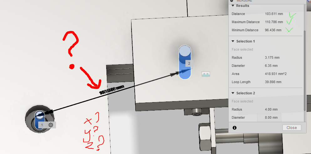

poplawa
Here is my issue with this tool:
Those black numbers are completely useless
Where are X, Y, Z deltas?
image below:
Message 8 of 18
HughesTooling
If those are holes select the edges not the surfaces or if they're cylinders select the end faces. I don't think it works with surfaces because where along the length would Z zero be?
You only get deltas between point to point or circle to circle.
Mark

Message 9 of 18
poplawa
Much better, thank you 🙂
