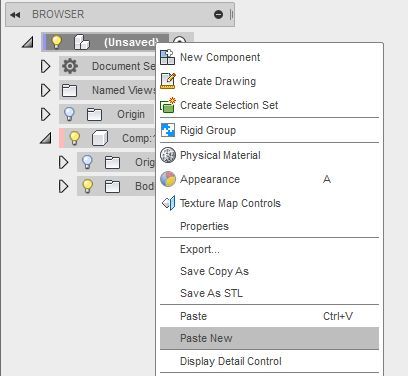

I have an assembly whereby I have copied and mirrored a single part to create 4 identical copies.  I first copied the part, then mirrored the pair to create the set of 4.  The first 2 parts (copied ones) behave as a pair so that when I create a sketch on one of them and then use that to make a cut, they both react and the cut appears on both parts.
The mirrored pair act in a similar manner but they do not copy the cuts made on the original pair, I have to do them separately.  This isn't a big issue, however I would have expected that what ever I did on the original part would be carried over to all copies of that part.  Since this doesn't happen I have to make the necessary cuts on the mirrored pair as a separate operation.
I now need to make a new cut on all 4 parts but I do NOT want the this next cut to be applied to the partner part, I need this cut to act independently.
How do I prevent this new cut from appearing on the partner part?  Is there a way to make the new cuts independent?

The one thing that escaped me for a long time is, that instead of using the MOVE/COPY functionality to create linked-clone components one can simply use CTRL C and "Paste new" to create "copies" which are not linked. You can do this by right-clicking the components in the browser only, though:

If you use Paste New the copy will be totally independent so you'll need to cut packets in all parts they will not be linked at all.
The first problem you describe trying to cut pockets in all parts including the mirrored parts. What you need to do is roll the timeline back before the mirror feature and cut the new pocket, when you roll the timeline to the end again the pocket will be in the mirrored components.
Your second problem is not so easy, I think you'll need to create a new component to get this to work. The safest way to do this is activate the top node in the browser or if you're in a sub assemble the containing component then use Boundary Fill from the Create menu, set the Operation to New Component the select the body you want to copy and select it again as the cell. This will give you a new component that is independent from this point on. The reason I suggest using boundary fill and not just copy paste of the body is if the copy paste ever breaks there's no way to reselect and fix the problem but with Boundary Fill you can reselect.
When you have your new independent component you can use Remove on the original or just hide it. I know this seems a lot of work but you can't pick and choose when components will be associative.
