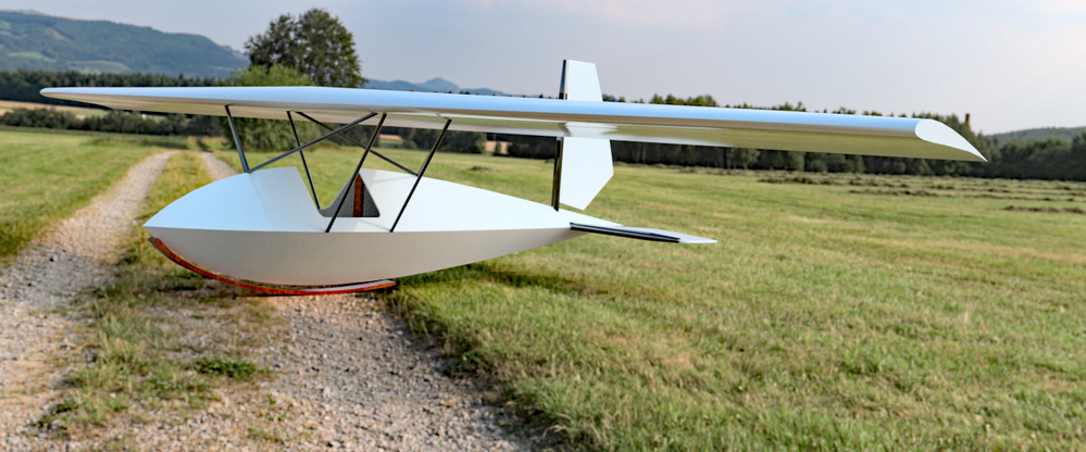

When I read this, in retrospect, it gives me the idea why I maybe had the same problem.
It concerns the hull of this model (simplified shown in this picture)
I drew the outer contour with a fit point spline and mirrored it. One sketch for horizontally and one for vertically. And in order to be able to adjust the shape afterwards, I parameterized the values.
After about 2 weeks of detail work and preliminary inspections in many places, I found that the hull was taller in height than in width. I could have lived with that, but it required a lot more effort to always mirror parts several times instead of just using circular pattern.
Since it was getting a bit cramped for the mechanical parts in the rear of the fuselage, I finally decided not to continue working on it, but to make a new model 20% bigger right away.
In my case, too, it probably had something to do with the order of the measurements. Before I continued working on the new design, I checked that everything was correct.
As long as it is not improved, you have no choice but to check it.

@wersy non need to mirror splines.
