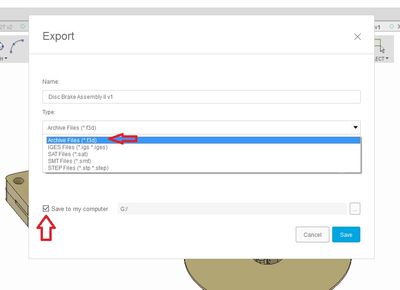

It should be the top option in the export dialog:
The fillets at the top step look identical to me.  The walls are different at the bottom step, so the fillets on that step are only on the right.   Perhaps a screenshot with what you think it should look like marked in red would help.
