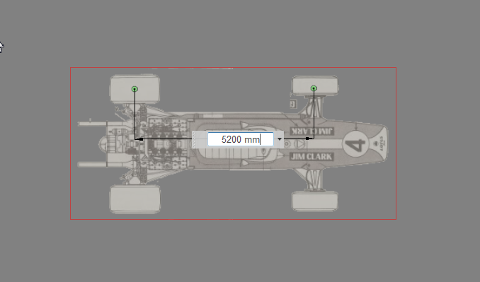

this method works great, @HughesTooling.  The other method is to use the Calibrate command, specifically intended for Canvases.  Select the Canvas in the browser, right-click, and choose Calibrate.  Then, pick two points on the image that you know the distance of, and enter the known value.  It works pretty well, in my usage:

@HughesTooling and @jeff_strater both solutions are amazing and helped to solve the issue. What if I was sent an image of a item that I did not know the dimensions to, is there a way to do this as well? Worst case I load up Photoshop and measure the item to use in Fusion.
Message 6 of 9
Hello @jeff_strater,
How can you be sure your points are precisely located ?
I tried this method, but it's (for me) dangerous
There is no automatic snapping for canvas corners or center, for example, which would be good start if png file is well prepared.
The idea is interesting and promising though, and I made a video to let you rapidly understand the limits of this solution, especially without some automatic snapping.
I would like to mention also an easy update which is surprisingly missing : set dimensions directly in Attached Canvas window
We have distance and scale, but as explained another user, to know the scale you first have to import once, mesure, calculate ratio, delete, then reimport.
This is precise (well, actually not - watch screen capture video “calibrate_sketch”), but setting dimensions would be just way more obvious and quicker 😉
Best regards
Message 7 of 9
jeff_strater
Yes, you are correct - there is no snapping in the Calibrate command, and yes, this can make it difficult to precisely scale a canvas.  It would be a good enhancement, I agree.
