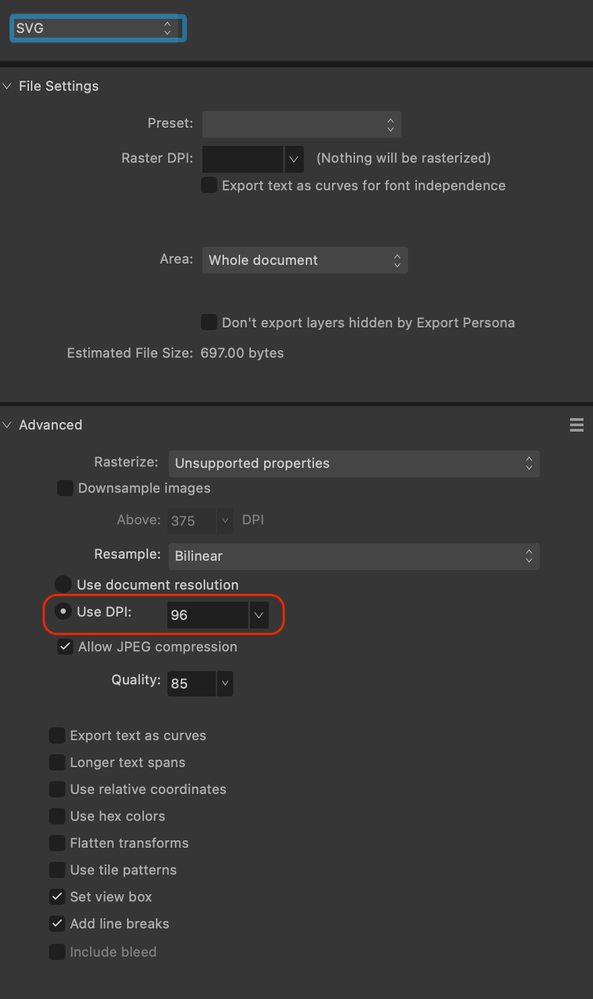

Hello all!  This is my first post here... I'm new to Fusion 360 (and loving it) and am happy to add to the discussion here.  I have managed to solve my own SVG scaling issue that hopefully can help someone else.  Specifically I'm on MacOS and I use Affinity Designer as my illustration tool of choice.  I managed to figure out the correct combination of document setup and SVG export settings. My document is setup for inches and 72dpi 96dpi.
Edit: After some more experimentation my results were not consistent and have since modified my settings and am now getting exact results.  96dpi seems to be the optimal export resolution and it doesn't seem to matter what your document resolution is set to as long as 96dpi is set in the export dialog.  A couple other things I noticed which may only be pertinent to Affinity Designer is you MUST convert your text to curves BEFORE you export (do not rely on the svg export - it isn't consistent) and also make sure to check "Flatten transforms." Without that my design elements seemed to not have a fixed location or size in the svg export.
Then my SVG export settings are as follows:

shofmannBKDTC
I'm currently using Affinity Designer 2 and was having issues with the scaling of it on import into Fusion 360. Changing the setting for DPI to 96 and not using the default document resolution solved my issue.
Here are my settings of the export panel from Affinity Designer 2 below:
