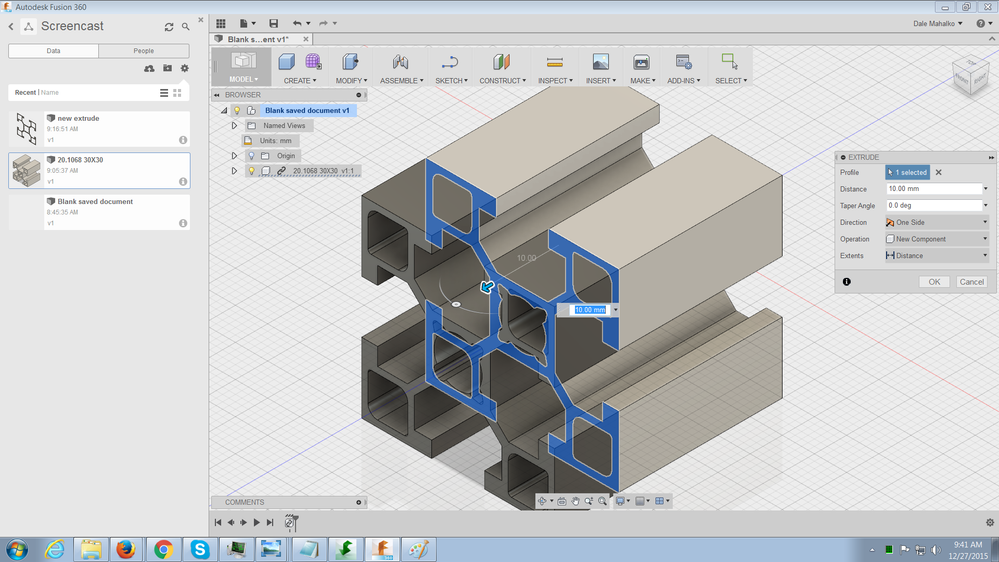

How do I delete the STEP object used to create the extrusion?
I don't need it after creating a new body or component from a face of the STEP, but A360 won't allow me to delete the STEP object.
Create new project "TEST"
Import STEP file into TEST project
Create new document in TEST project, save it, open it
Drag STEP object into the editor window
Select face on STEP object to use as sketch
Extrude to new body or new component
(at the moment I don't know the difference between a body or component, but the choice doesn't seem to matter for this example. I get the same result below for either choice.)
Name new component "10mm Extrude"
Select STEP object in the browser tree with the chain icon, Delete
Warning: This feature is referenced by other features in the timeline.
Delete anyway. There's nothing indented under the STEP object so I have no idea what that means.
The new object is still visible but now I have an exclamation point in the bottom right corner.
Warning:
   Extrude1:
      Reference Failure:
         Failed to get target occurrence transform.
         The model is using cached geometry to solve. Please reselect reference geometry for failed features in the timeline.
So how do I get rid of the STEP object?
