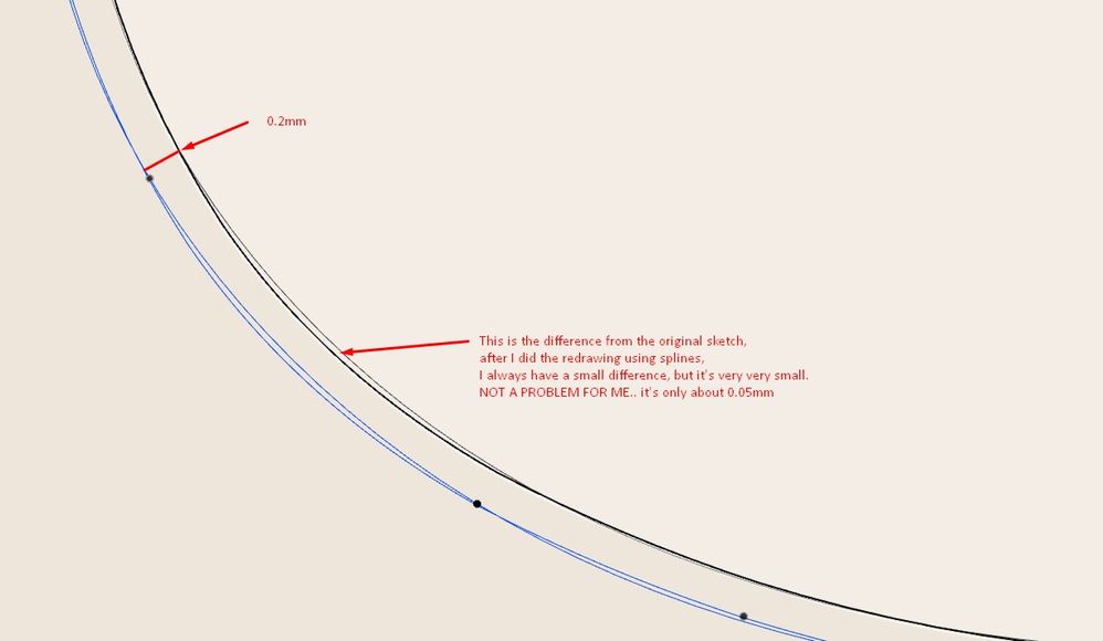

So I already  lost 30 minutes trying to make the 3D model, I started redrawing the sketch in Fusion like you always suggest, I did it with splines, only half of the model and mirrored it, I did the internal offset before mirroring .. everything went good, the model as you can see bellow , but there was something weird, when I selected the edges for extrude, somehow, the original sketch, which was hidden, had influenced my selection, as all the very small 0.005 differences ware not extruded, .. now I still can't do the draft operation, even if the 3D model looks much better, with a continuous curved shape, not an frequently interrupted one

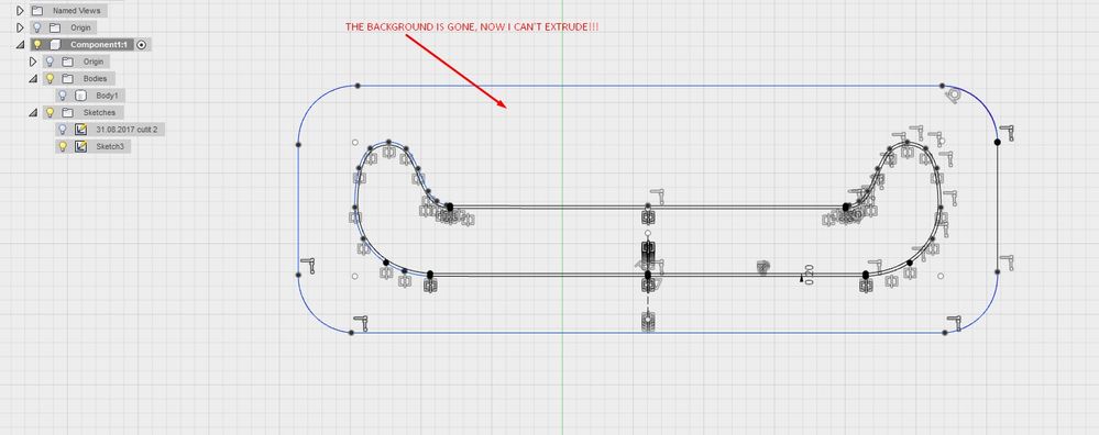

After seeing the new issue I tried to figure out where it comes from and noticed the difference between the original sketch and the new sketch3 that I did in fusion, the original sketch was hidden from the LIGHT BULB icon, but when selecting the lines for extrude I could see some light orange lines, those ware the original sketch, i right click the original sketch and pressed HIDE PROFILE .. and toggle that a few times while checking the lines, but now my new problem is the the background of the new sketch is gone, and I can't extrude it anymore ?
I will start everything from the beginning, with a new file, but please can you tell me if I can somehow regenerate that yellowish background in my sketch so I can do the extrude, on future designs.. ???

Not sure what you are trying to explain with these sketches but see are several suggestions:
1. Use fewer points on your spines and work with the spline handles to get your form.
2. Don't mirror a spline. In Fusion 360 that's a bad idea.
3. It is unlikely that drafting such a thin walled structure will ever work. Draft the outer contour, splint it off, shell it and combine-join it.
4. Of course this cannot be drafted beyond 15 degrees. The inner radii at the bottom of the drafted  structure change collapse beyond 15 degrees.
