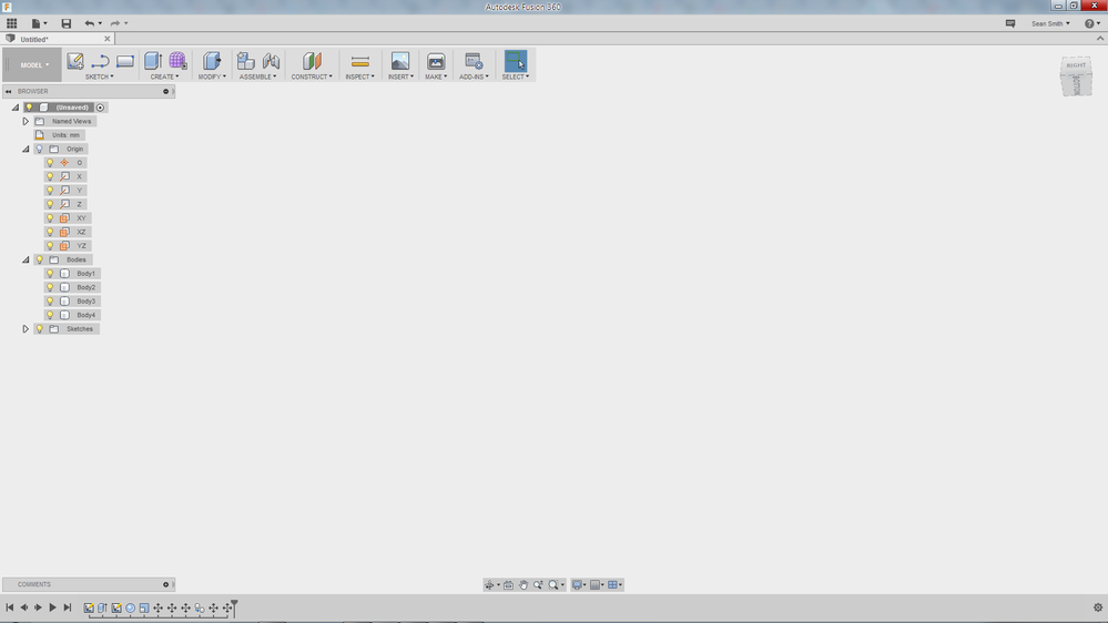

I can't find my objects. I rotated the screen and now I can't find them. Everything is white, wherever I look. This screenshot gives some insight into the situation.

Try the house on the Nav Cube or double click middle mouse button
