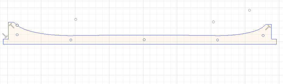

OK so if you look at the screenshot, sections 1 and 5 are actually ellipses.    Section 2 and 4 are normal arcs and section 3 is a flat piece I added to reference in unbend.
Everything seems tangent.  It behaves like a watertight sketch, will extrude, etc...

I can't see any tangent icons.  Extrude works, but would it work as a rail in loft (Not G1 continuous)
Mine worked, yours must be different.

Ah, I see.   I added the tangent constraints to the drawing.    I am now having better luck with bends and unbending, however I am having issues now that I didn't have before.

Thanks.      I am suspicious of the ellipses wreaking havoc.
I have had issues in the past with sketches not solving due to problems with ellipses.  One of the AutoDesk engineers basically told me that "Fusion sketch solver struggles with trimmed ellipses" and if I can use a different curve such a spline instead.  Also it was mentioned that circular arcs used to have many of the same issues but have been solved.  Ellipses since are used less, hasn't had the attention, so some of these problems still persist.
This was in the context a sketch, not sheet metal, but since the sheet metal is driven by the sketch I am suspicious here.    My next move (if my other thread doesnt get some ideas) is to redraw the mold without ellipses.
Message 34 of 34
davebYYPCU
Yep, ok,  you got it, ellipse should work, but change them out for tangent arcs
the face of my mould is tangent arcs, and that is likely a requirement for the unfolding.
Whilst an an ellipse is a cylinder sliced on an angle - curve, the elliptical curve might not work in fold / unfold.
