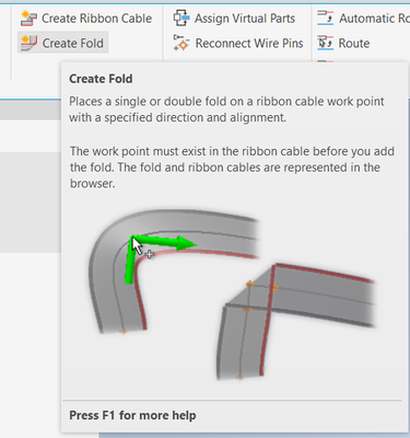

TheCADWhisperer
@timF4ETD
Since you asked 🤔
I would use Autodesk Inventor Professional - Cable and Harness - Create Fold
But I'm sure there is a way in Fusion 360 to do it manually.
