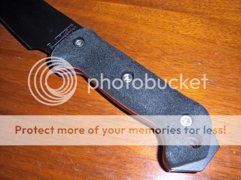

I have to simulate a "spark eroded" finish on a mold with rotary tooling. I have some rough grit media coming in next week to try to sandblast it but if that doesn't work I may have to machine it.
Anybody ever have to do this?

mike.mattera
In the past I've done something similar. A customer wanted to do some stippling on a knife handle. I suggested he raise the value of the tolerance for the cut on his 3D surfacing toolpath. Try a tolerance of .004 - .002 (inch) and try a test case to view the finish.
http://i311.photobucket.com/albums/kk462/Tonecod/handlemods003.jpg

fishtruk
Thanks Mike,
I had given up - just now in fact.
The last image is exactly what I need albeit scaled down. Could you tell me how it was drawn?
And you mention 3D surfacing, which cut operation are you referring to?
Thanks a ton!
Message 5 of 13
mike.mattera
You dont need to draw anything. The surface is flat. You can use any toolpath you like. The one you choose will also effect the stippling appearance. A spiral toolpath would probably make it look more random than a linear/parallel. A small step for the cut and a large tolerance. You're essentially asking Fusion to create a sloppy/inaccurate toolpath over the surface.

mike.mattera
Spiral Toolpath. 1/16 Ball Mill.  .01 step over.  .03 tolerance.

mike.mattera
Nothing to design or draw with my method. You use the existing model.  You should probably add .020 stock and then use a .03 tolerance, so you dont cut to deep into the part.  Hope you found this useful.
