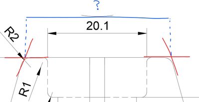

How can I create this dimension? I understand you could modify the part to not have a fillet, and then just add a note that it should be filleted, but I won't do that for many reasons.

place a point close to where the red lines intersect, then add a coincident constraint between the point and each of the lines.
laughingcreek
fyi-if you create a dim between the corners before creating the fillets, fusion does what's described above for you when you create the fillets.

well crap, just realized your talking about in drawings, not in the modeling space.  when I have a min I'll answer that.  oops
laughingcreek
one of 2 ways, one of each shown here-
the point on the left was created with the edge extension tool under the drawings geometry tab-
the one on the right was created in the modeling environment.  projected the face of the solid into a sketch, selecting construction  line type for the projected lines.  then placed a point as previously described.  then when your in drawings you can toggle the visibility of this sketch on and use the point to dimension to.

Edge extension, found it, thanks!
