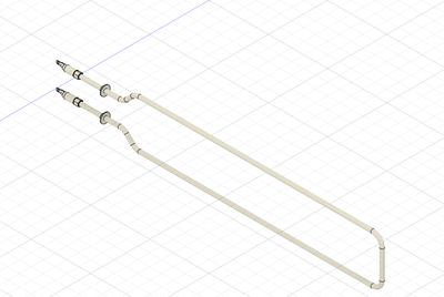

Hey, everyone. New Autodesk user here. I am trying to make a fractal magic wand which entails sizing the fractal to 1.5mm and wrapping it around the cylindrical surface of the wand up to the part of the wand that has the washers on it. Can anyone teach me how to do this?

My first advice, just based of hearing your request is to use the emboss tool to wrap something, but I'll give you some better advice and share a screencast once the file opens for me
*First question from me, because you haven't named anything and sketches don't exist here...
Your trying to scale the meshbody 1 to 1.5 mm and wrap it round the wand skeleton structure to make that design, because if that's the case there's a simpler way

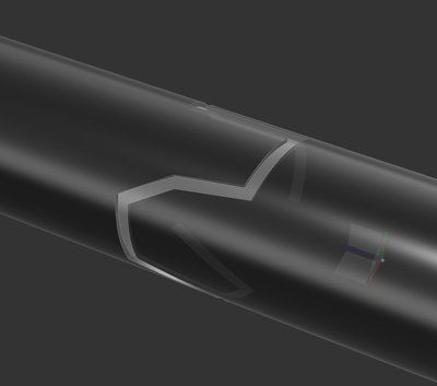

Warmingup1953

amszabo
That is correct. I am trying to scale the meshbody1 to 1.5mm and wrap it around Body1 (the wand) at all points just before the circles near the base of the wand.

TimelesslyTiredYouth
1. What you have, is a skeleton...
2. It needs to have an outer surface to do what @Warmingup1953 did.
Here are the steps to follow, as using an imported skeleton structure isn't the greatest way to learn or go on with this project.
1. At the back end of your skeleton, make a sketch, where you draw a centre point circle that alligns with the wand skeletal strucutre, 2. extrude, it to the end of the wand where it becomes too thick to go to the next section.
2. This leaves you with a solid body which can have the emboss tool used on it.
3. Select the emboss tool, select both the newly made cylinder and the design ensuring that the design is wrapping the cylinder, change emboss settings to engrave, and watch the magic!
4. The rest of the wand forward from there can just be done via more circular sketches extrusion and fillets, with a few chambers to get the rigt shape!

Goodnight @amszabo
READ THE WHOLE THING FIRST, MAKE SURE TO CONSTRAIN YOUR DESIGN ALONG THE WAY UNLIKE ME AS I RUSHED AND START WITH A SOLID BODY, NOT A HOLLOW LIKE HOW I STARTED, YOU'LL UNDERSTAND WHEN YOU'VE READ EVERYTHING...
First made a half side profile sketch
used the revolve tool to quickly revolve sketch (Mine is a bad example as I'm not taking dimension/looks into consideration, just thinking as a quick example)
found in surfaces section...
thicken, (left inside hollow, in case want to put something inside while cosplaying to shoot out of wand...)  *I TAKE BACK WHAT I SAY, FILL THE FULL INSIDE
Fillet and chamfer and chamber as required/ wanted for your specific shape, or shape the starting sketch much better actually...
Just a quick offset plane in construction bar
just a quick sketch on that offset plane.
Use the emboss tool, and deboss to engrave it into the wand handle. (Right hollow the wand at the end, I didn't realise engrave doesn't worked on hollow bodies...
This creates an engraving on the handle...
I think you should've accepted to make a proper "true fractral wand" as it isn't possible unless your refined accurate and Idk's where our refined accurate guy is so yeh... But your best bet, is where I made the sketch, make a close as possible sketch of what you want to engrave on the wand and then engrace it. (I hope you can do simple maths, so find the diameter of the wand handle, and make sure the sketch is exactly that height so it all matches up and looks good)
