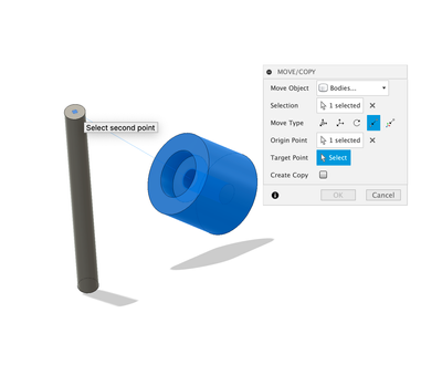

Hi there, I want to design an implant, the basic structure of which involved 16 sets of cylinder and ring as shown in the first figure.  First rule of the design is that all rings or cylinders are same in size, but different in position and location. The other rule is that the lateral surfaces of the ring are parallel to the lateral surface of affiliated cylinder.
The cylinders were imported from elsewhere, so their location and position are already fixed. What I need to do is to generate rings for each cylinder. I drew one and aligned it with according cylinder so that they would be parallel. I don't want to repeat this procedure for 16 times. Therefore, I tried the 'move and copy-point to point' function. However, no matter which structures I selected, face or circles or centres, copied rings won't fit exactly (the second figure).   Is adding a second step of aligning is the only solution to this problem or I just used the 'move/copy' function wrongly?  If so, what's the correct way? Thanks very much!

Normally create one set of parts complete, (built in place helps)
then copy it 16 times with a Pattern.
Copy / Move point to point, should not cause errors.

Here's the process I would use, but bear in mind that we have not seen your data/model.
Firs I would upload the design with that cylinder and see if the origin in it is in a sensible location. Often it is, but sometimes it isn't. I would NOT enable the timeline in the design of that cylinder. If the origin is not in a sensible location, e.g. in the center of the cylinder, or centered to the end-face of the cylinder, I would use the point-to-point move operation to get it there and then save and close the design
Then I would create a new design and create a new component. Lets call it Cylinder & Ring Assembly.
The component is automatically activated. Now I would insert the cylinder design from the data panel into the new Design. If the origin of the cylinder was in a sensible location, I would not create an as-built joint between the cylinder the the origin of the  Cylinder & Ring Assembly component. That will lock the cylinder in place in that assembly.
Now, with the Cylinder & Ring Assembly still activated, I would create another component Ring and make sure it is activated (it should be by default activated right adfter creation).
Create the necessary sketches, construction geomertry and 3D geometry for the Ring.
Activate the  Cylinder & Ring Assembly and use an assembly joint to join the Ring to the Cylinder.
Activate the top level.
Use a joint to place the   Cylinder & Ring Assembly to the location you want to start the pattern.
Create a component pattern. with the Cylinder & Ring Assembly.
Create a Rigid Group Joint (with Include child components un-checked!)  including all instances of the the  Cylinder & Ring Assembly including the seed instance.
Now you have a proper and fully parametric assembly.

I think what you want is actually quite simple. Instead of using the move command use the 'Align' command under "Modify"
Here I approximately drew your parts. Then I moved the angle position of the parts around to look like your cloud of parts.
Pick align, pick the round end of the bar, then pick the edge of the hole.
The parts align like this.
Then you can use the move command on the cylinder object to slide the cylinder back and forth in the hole into final position. Voila! maybe?

Thanks for your detailed reply. This workflow does work for my project. I'm a beginner in Fusion 360. Move/Copy and Align tool is easier to grasp, but I hope there is a more efficient approach. Therefore, I'll spend extra time exploring other choices suggested in the replies.
