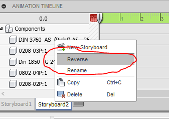

@stefano.cottafavi2YQRW
try this -> right mouse button on storyboard -> select "reverse"
-> see attached avi
Hi @Anonymous
simple and effective. Exactly what I was hoping for!
Thank you very much.
