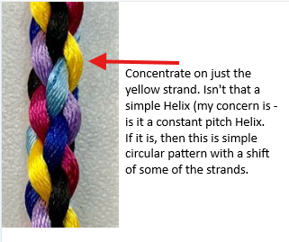

I would experiment with circular patterns of several helixes (Coils).
Give it a try and post the *.f3d file of your attempt here.

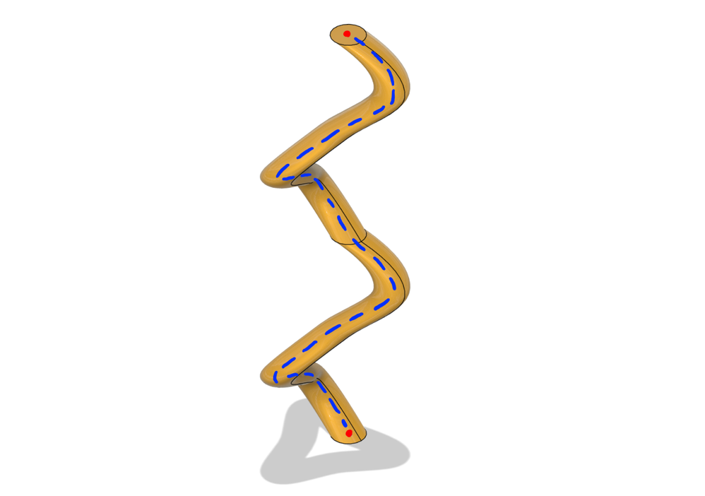

Hello! Thank you for your answer. Sadly it is not a simple helix since it bends around the other strends. See images
below of a sloppy loft I manage to do. If you have any advice concering the lofted version it would be appreciated.

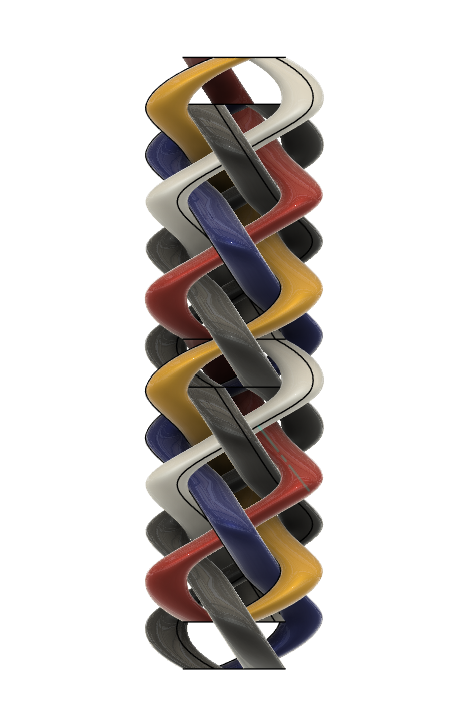

mariahagnell
Screenshot 2025-01-13 120617.pngScreenshot 2025-01-13 120627.pngScreenshot 2025-01-13 120805.pngScreenshot 2025-01-13 120813.png

Hello all and thank you so much for your answers. I've tried different ways and the easiest and best version was doing lofts around around helix sketches. See pictures. What I would like to do now is make a sketch following the center of the strand, see the blue dotted line in the attached. Is there any way to do that?Screenshot 2025-01-13 122448.png

Clearly, there is a visible repetitive pattern in that rope. The task is now to break that down into its individual constituents and then model those. That isn't any different from any other modeling task. Once that has been accomplished, creating "good enough" geometry is possible.
The OP, judging by the images in some of the later posts, has made significant progress!
I currently don't have the time to decipher that. Below is an object I modeled entirely in Fusion just for fun, just to see if it can be one. This was not trivial!
If a user came to the Forum with this image, would you also advise them this cannot be modeled in Fusion?

Hello all! Glad to see this topic has sparked debate. It seems like a tricky problem many are interested in learning more about. However, please try to keep the tone civil. I appreciate all your responses and value that they are different and contrasting, as it gives me a better understanding of the problem's complexities and lots of inspiration on how to move forward!
As for those who wondered if I can share the file or if I’ve made more progress, I’m afraid I can’t do that right now due to a confidentiality agreement. Hopefully, I can return to this post later!
That said, I did "solve" it after many, many hours. I ended up using my lofted "strand" as a guide and then used the 3D sketch tool to manually create a sketch that rotated as well as curved through different planes. This allowed me to give the braid the look I described in my original post – resembling strands braided with small pearls on them, using a simple pattern on path. I’m sad that I didn’t figure out a faster way to do this, but I’m happy with the finished result!
Thanks all!

For those that are still interested, the screenshot in the initial post came from a YouTube video that explains how this braid is created. THe best way IMHO is to replicate this with actual cords. That will then inform how this can be 3D modeled:
