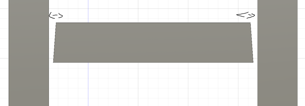

Thanks for reply! I have a another question. How can I mate two planes with different angles? I want make easel stand. There is also different like SW. Edit: I solved this problem.how.PNG
