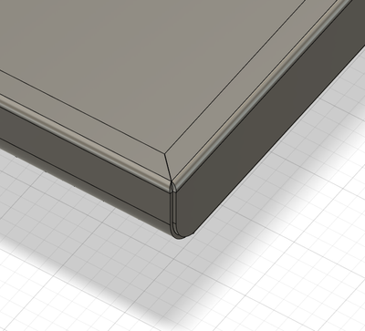

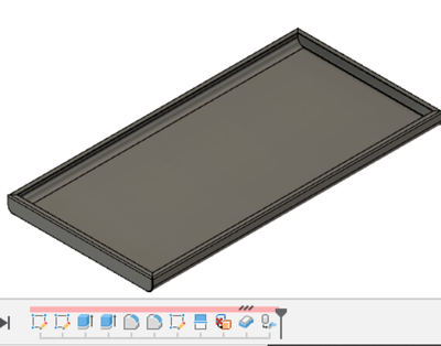

Please see attached picture and file.  How do I make a mitered fold on the inside of this corner?
I have tried offsetting the fold edge and all sorts but as soon as I turn on two edges I get an error.
Ashley

It would probably be best to do this entirely in the Sheet Metal workspace:
The order making the flanges is important.  Start with the end, then the side.  Override the side bend to 14mm.  Create the mitered flanges by selecting both edges.
ETFrench

ashes.man
@etfrench Thankyou for taking the time to look at this.  I was really hoping for a solution that worked with my existing design.  The large gaps and holes created in the corners by the bends are not ideal and have been closed up in my design.  I guess I could manually modify the unfolded layout to close them up?  Having the whole design as sheet metal does make things a little easier.

For reference, attached is a solution that gives nice corner overlap with minimal gap and equal set back on both sides.  It is based on my original design and unfolds correctly.  It is not as nice in some respects as a design based solely on sheet metal tools but IMO gives a better result.
But, in respect to my original question.  It seems there is no way you can create a mitre on overlapping corners using the flange command.  You need to remove the overlap first.
Message 5 of 10
etfrench
Correct, you can't have two flanges occupying the same space.
