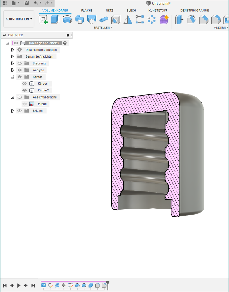

Pretty simple concept really but I do not know much about how to measure a thread, pitch etc...
I would like to create a 3d printed part that screws onto this pole threaded end.
The blue part is 18.4mm overall diameter, 19.5mm high from where it joins the steel to the flat top.
~15.3mm diameter inside the threaded area. The threads are ~3mm thick and there is ~2.2mm of vertical gap between threads. So that make ~5-5.2 pitch? As for the thread angle I'm not sure, I measure ~5 degrees from horizontal.
Any tips on where to measure, what is important etc.. would be much appreciated!

mango.freund
Message 9 of 9
877cms
can you not measure the plastic diameter? is it 19.5 or 19mm?
Hi, it measures 18.4 on the external of the thread.
Thanks very much for the f3d, looks complicated for my level of knowledge!
But I can see what you did and it's very good!
