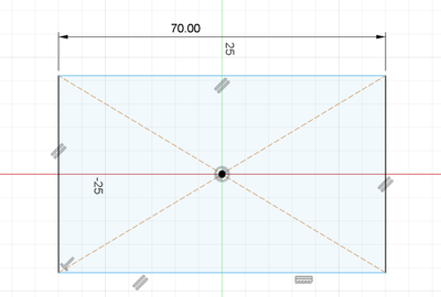

Create a Centre Point Rectangle on the Origin.
1. Create Sketch
2. Pick a Plane
3. Select Centre Point Rectangle from the Menu
4. Click on the Origin as the centre and make any old rectangle to start with.
5. Notice that you have a rectangle that is blue and the little Icon in Sketch on the Browser at the side has
a little pencil. This means that the figure you have created has a closed boundry that is a pre-requisite for
all extrusions. Any closed boundry will have a blue internal part. The Sketch icon means the figure is not
Constrained. The blue lines are also unconstrained.
6. Constrain the figure by clicking on the Sketch dimension then click one side of the rectangle.
Type the size you want the rectangle size to be in the box and press Enter.
7. Notice the sides have turned black, you have constrained the distance between the two sides.
Now do it again for the other sides.
Now notice that both sides are black and the little Icon in the Sketch menu on the Browser has changed
to a little Lock. This is a fully Constrained Sketch.

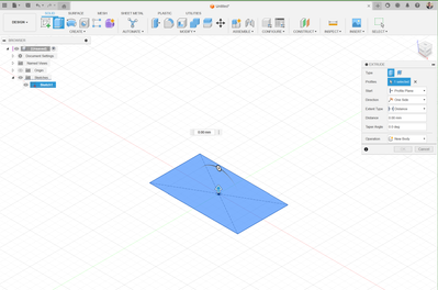

9. Select Extrude from the menu or just press "e".
It should now look like this.
10. Extrude the body by pulling the arrow, or entering a value and press Enter. Now you have a Body we can
start to model.

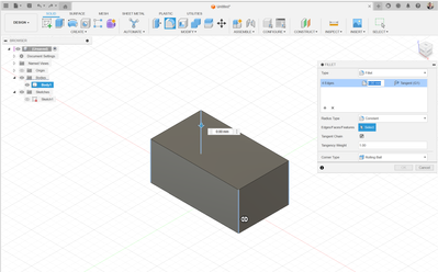

11. Select the Fillet Tool or press "F".
12. Select the edges you want rounded. You might have to use the View Cube to rotate a complex model but
with a simple model you can often hold the cursor over the hidden edge, it will highlight and click to select.
13. Enter the radius you want to make the Fillets and press Enter.
