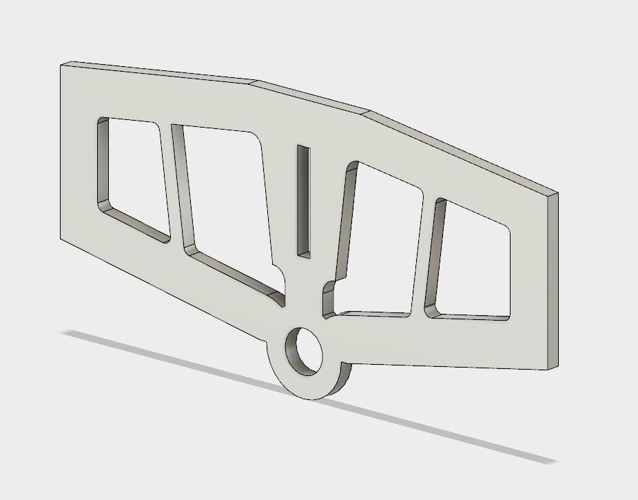

The Top Plate needs to connect to a Cross Plate that will have the legs connecting to it and the rest of the lower section of the Frame.
I started to Cad up the Cross Plate. I probably broke every rule in the book, but I am trying to work from a sketch in fusion.
This is what I came up with.
I intend this to be a skinless R2, that has more movement abilities. Such as side to side pivot, forward and back movement, complete leg rotation. I added the lower hole for the side to side. I want two holes on each side to allow rotation of the legs, but the sketch wasn't letting me place them center of the 30mm sides. I have to work that one out.
The Center slot is for a 160mm spacer that will join this cross section to a duplicate cross section.
Hopefully you can see where I am heading. This is like a shoulder section that will support top plate, legs and lower section.
Feel free to decimate the effort. I am not used to sketching in fusion and may have been rather messy.
Kind Regards
Ian
Message 86 of 95
chrisplyler
This is almost an hour long. You don't have to watch all of it if that's too much. You can skip ahead where you feel you already understand something.

ianhughes7UFVF
Hi
I watched the whole hour and thoroughly was absorbed in your explanations, corrections and consideration of what I did.
I am absolutely impressed by how well and clear you explained everything. I appreciate your time.
I was creating the Cross Section as I went, and as I was going, wished that I had been able to do half and mirror it, as I saw as you were going the mistakes I made.
What I learnt was:
1. Make a component first (I should now this rule by now, and cursed the fact that I got half way through and remembered to do it)
2. Use the origin points of the component rather than the parent origin (I have struck 3d cad files that they used the mother origin and the component is away from it  and it makes it difficult to join in external files)
3.Use Construction lines and constrain them as you go (I didn't do this at all, but can see the definite correctness of the method)
4. Create a construction box and then use the midpoint command to join them.
5. Coincident allows you to connect one line to another (Using the Sketch commands more is definitely on my agenda)
6.Using the Horizontal/Vertical to constrain lines
7. Use midpoint to locate lines
8. Trimming lines out
9. Defining Dimensions regulary.
To list a few.
I wish these screencasts were downloadable as I would have yours on my desktop and refer to it constantly.
I do apologize for my mistakes in the design which you corrected perfectly.
Next I need to go back and redo the sketch from scratch following you presentation and learn to use all these commands correctly.
Kind Regards
Ian
