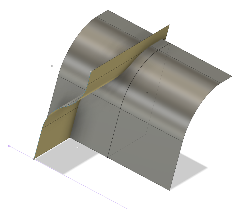

How to make this ? I used the 3D sketch feature in fusion but stuck after sometime. any advices?

3D Sketches are for braver men/women than I!Screenshot 2023-12-04 163026.png
22JE0190
Creative...I think I should now learn surfaces.
Thanks buddy
Warmingup1953
Me two! I rarely use them but here is my go at FWIW!
